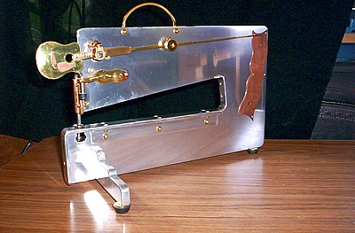

      Here's one I made a few years ago. It's fully adjustable and I use it all the time for lots of different things . It's a bit of fun and always puts a smile on my face .
Doesn't measure down to thousands ( in fact it's metric ) but the increments are easily fine enough for guitar work
Regards KiwiCraig

Thanks Arnt. Sorry , that's all I have stored on my computer and don't have a camera at the moment.
     Made it out of scrap lying around.
The treble upper bout on the little brass and copper guitar acts as a cam .I've used bronze (off an old horse buggy) for the wearing parts .
The dial was made from a piece of copper pipe I split and flattened. I engraved it and filled with black enamel . It measures exact !, There are three adjustments to fine tune it, should it ever be required.
The part I am very happy with is the little round base of the measurement area ( don't know what it's called. )It has a part spherical bottom which sits on a bronze rimmed hole . No matter what angle you have the wood to be measured , it reads accuratley. I t annoyed me with other calipers , that you have to muck around to find the lowest type reading ,by shifting the wood until you have it parrallel with the unit . It's a fault of most micrometers

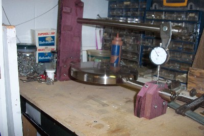

Here's one i made out of purple heart and a recycled stainless steel lamp
PostPosted: Tue Aug 08, 2006 12:17 pm
Your the king of recycling there Serge, living in such a large building has it's advantages eh?
PostPosted: Tue Aug 08, 2006 1:35 pm
Nice job, Serge! Though it kind of looks like you actually recycled a banjo...

PostPosted: Tue Aug 08, 2006 2:35 pm
Rod and Carlton, my middle name is Scroungy!

Posts: 720
Me too Serge .It's always interesting to see what you can come up with .
I cut the little guitar out of an old brass puncture repair clamp . One bracket was cut from an old window fitting and found a bronze bracket I cut up from an old horse buggy . The aluminium pieces are cutoffs I scrounged
The spindle for the dial indicator / counterweight arm is from a record player turntable . All the copper was from a copper pipe I split and flattened .
I find that when you go looking through little bits and pieces to fill a need , you are often sparked by an idea .
I love all the individual efforts on show here . Well done guys !
   Paul , It actually does have a brass into copper inlay !    I'll try and get a close up sometime.

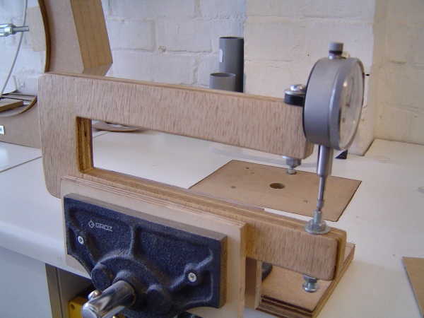

I'm a great believer in keeping things simple, so when I needed a thickness caliper I went down the simple route. This one I made Ive used for many years and find I want nothing else. Simply made of plywood, with a dial indicator and rounded bolt the handy thing about this one is you can put it in a vice for ease of use and stability, just run the wood between the jaws. Took about 30mins to make from a dial gauge and scrap.

PostPosted: Mon Aug 14, 2006 9:52 pm
Colin, i love this simple and effective concept, i will dismantle mine, use the purple heart for my guitars and build one like this !!!!
